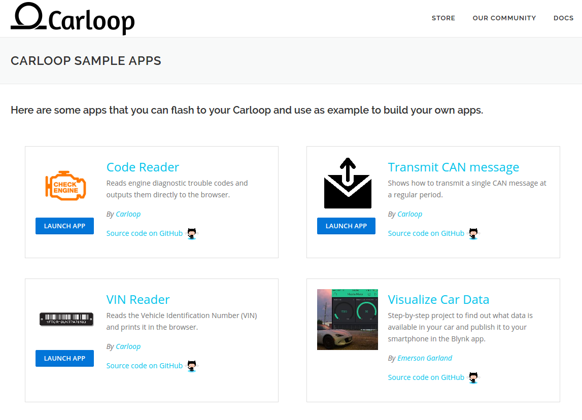

can’t seem to import the project into the carloop community… ill research how to get that working later.
Fantastic write up! If you’d like I can include the link to your Hackster post in https://www.carloop.io/apps with proper attribution.
Totally fine with me! Sounds great!
