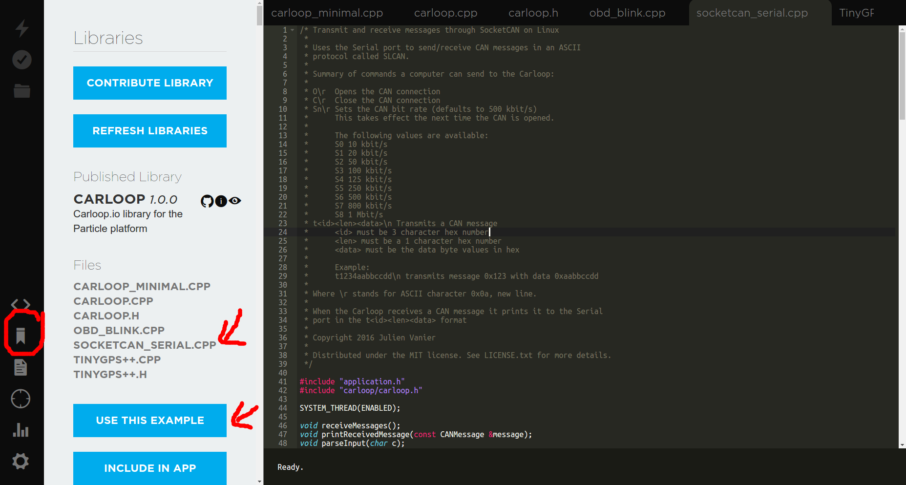

You’ll need special firmware on your Carloop to print received CAN messages to the USB serial port and allow transmitting CAN messages sent to the USB serial port.
Flash the SocketCAN serial firmware application to your Carloop. The easiest way is to go to https://build.particle.io, select Libraries on the left, search and select Carloop, then open the socketcan_serial.cpp example, click the Use this example button then flash to your device.
