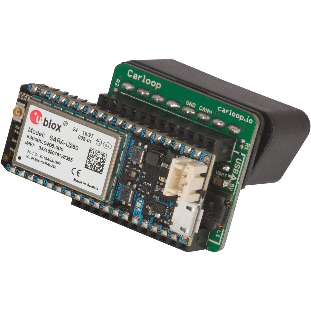

I just purchased the carloop, electron, and this GPS module. I am unclear how these three devices look once they are all plugged into each other.
Looking at this image:
Where does the GPS fit in? On top of the Electron?
Would you be able to post a picture of the three devices connected?
Thanks!

@Nathan, In the image you provided, do you see there is an extra row of header sockets right beside the rows that the electron is plugged into? That is where the new GPS module will plug into, and it will sit up above the electron; it would be in the foreground if it was added into the image. It looks like it will extend slightly beyond the edge of the Carloop, but not a much as the electron extends. This assumes that I read the dimensions correctly.

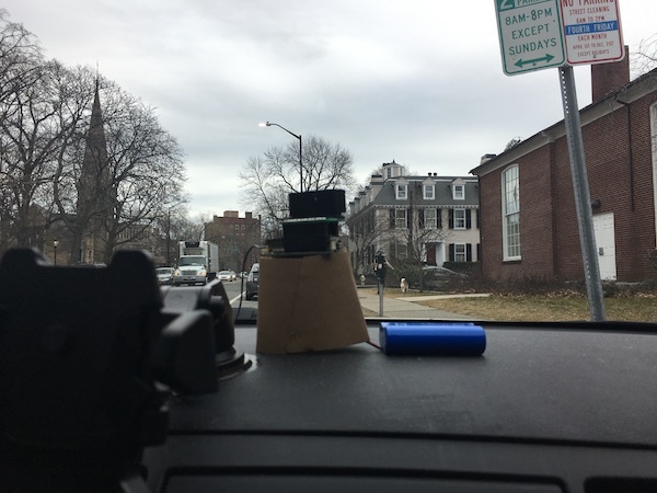

** Please see my later post for updated tests, I’ll leave the original in quotes below for posterity **
As promised, here are my results–
Summary:
  • In the OBD-II connector of my car, pointed “earthward” under the dash, it will never obtain a GPS fix, even after 20 minutes
  • On the dashboard of my car, pointed “skyward”, it will obtain a GPS fix in about 90 seconds
For the FW I took the carloop-minimal example code from the carloop library on build.particle.io and I modified it to publish the result of gps.location.isValid() every 60s or immediately if it transitions from false to true.
I repeated each effort a few times, each time with the car stationary, the ignition key OFF, and my Electron 3G US running off a fully charged 4400mAh lithium ion battery (to make the tests in and out of the OBD port equal).
I also ran a test where I kept the carloop faced “earthward”, but sitting on a plastic container on my car’s seat (to eliminate my dashboard as the major signal blocker), and it still did not obtain a GPS fix after ~15 minutes.
So effectively I’m confirming my concern that the GPS will not work well (or at all) when in the typical position that an OBD-II port will place it (earthward, underneath a bunch of metal/plastic).
Downloading almanac data or enabling assisted-GPS are all possibilities to make things work better, but they don’t change the fact that as it is designed this will not work very well for its primary function (GPS) and without an external antenna port there isn’t a good way to enable it.
That said, I do not plan to request a refund because I think that despite the GPS reception issue it offers a good set of features in a small form (GPS, accelerometer, SD card) and I think this could easily work for other designs where it can made to face skyward, or where OBD can be extended to allow that orientation – but I do really hope that Carloop considers an external antenna option on a respin of this board sooner vs. later.

I see your point–does being on the dashboard vs. elsewhere inside the car make a bigger impact than facing earth vs. sky.
The weather here is getting nicer, so I’ll try a few out-of-the-car tests to really nail down whether orientation is causing the issue or not. I’ll try to post some results by the end of the week.
I’d also really appreciate it if the Carloop folks would consider updating their libraries at Particle.io to make use of A-GPS or almanac downloads. I’ve considered both of those for the tracker devices I’ve got going w/ Particle’s Asset Tracker shield, but since those devices perform fairly well w/ an external GPS antenna (and they have coin-cell battery backed almanac storage) it hasn’t been necessary to get into it.
Hi @cyclin_al1
At your suggestion I re-performed several of the tests to try to better understand position vs. orientation–
My original concern was that Earthward orientation was going to have a negative impact on GPS fix and it would be compounded by positioning under the dash. My first set of tests in my earlier post were too limited in that they changed both orientation and position together, so while they did prove to me that the Carloop GPS won’t get a GPS fix while plugged into my OBD-II port, they didn’t prove whether orientation was a factor in the problem or not. So, I revisited the tests with changes to attempt to determine whether it was orientation or position that caused the GPS fix issues.
A few specific points I wanted to address after my latest set of tests–
  • You were absolutely correct that position in the car was a larger factor than orientation, in fact in these new tests orientation does NOT seem to matter at all, so my original concern over that is settled in my mind: Orientation does not impact GPS fix time
  • My original “on the seat” test was invalid–I realized after I posted that I had the chip antenna in physical contact with the plastic tub I used to keep it up off the seat… I now believe that physical contact w/ the antenna was the cause of not getting a GPS fix in that case, not the Earthward orientation. The GPS antenna in physical contact with an object may prevent GPS fix.
In the new tests I tested the Carloop GPS running w/ a Particle Electron 3G off a 4400mAh battery. I used 3 different positions in the car: “on dash”, “under dash”, and “on seat”. With on/under dash I used two different orientations: Earthward and Skyward, and with on seat tests they were all Earthward orientation but one with the GPS antenna in physical contact with something and one without.
For this set of tests I used a cardboard coffee cup sleeve to keep the GPS antenna from touching anything when in the “Earthward” orientation.
Position “On Dash” –
Whether oriented toward sky or earth, the GPS fix happened within 50-90 seconds.
Oriented toward Earth:
Oriented toward Sky:
Position “Under Dash” –
To simplify things I didn’t use the OBD-II connector this time, instead I placed the device on the floor of the car under the OBD-II location. No GPS fix occured within 6 minutes, regardless of the orientation.
Position “On Seat” –
This position was different from the others in that I didn’t test orientation, but rather whether the GPS antenna being in physical contact may have made my earlier test invalid. I didn’t have the plastic tub with me this time, but I figured the seat itself would do… What I found was that when the antenna was not touching anything a fix was obtained in about the same time as the “on dash” positions, and when the antenna was physically touching the seat no fix would be obtained within ~6 minutes. My assumption is that my earlier test in this position was invalid because the GPS antenna was resting in physical contact with the plastic tub.
Oriented toward Earth, but with GPS antenna out of physical contact with anything, GPS fix in about 90 seconds:
Oriented toward Earth, but with GPS antenna in physical contact w/ the fabric seat, no GPS fix even after ~6 mins:
If you’re still reading, thanks for your interest, and I hope that something I posted here may be valuable or at least entertaining.
…and yes I did sit in my car for about an hour doing all this, but fortunately it was still within WiFi range of my office :slight_smile:
