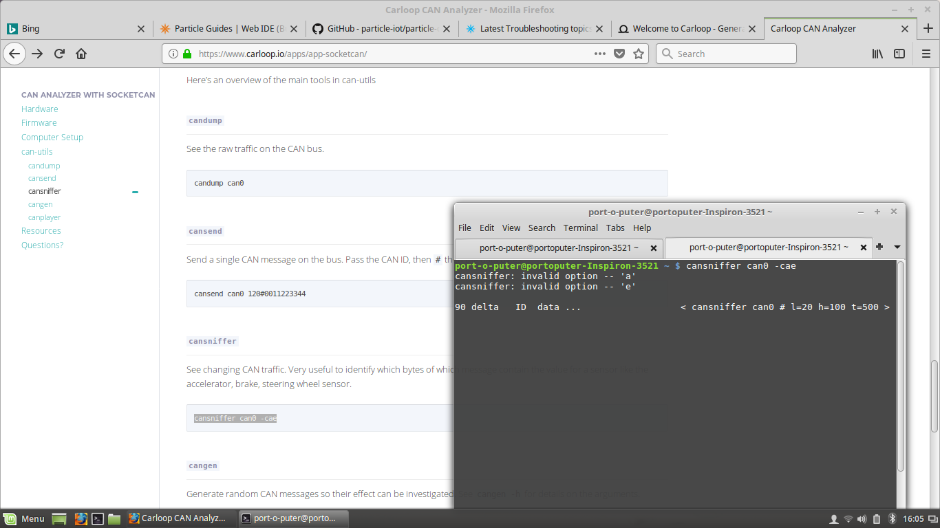

But as seen in the first picture command “a” and “e” is not understood and I see no packets

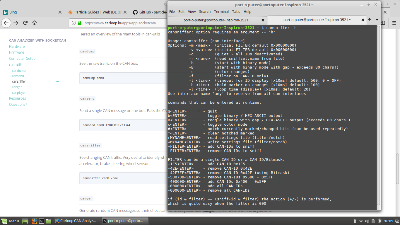

I took a look at the GitHub repository for can-utils, and I did not see anything to explain the a and e parameters. I am not sure if they are supposed to be values for the colour setting, or if they were meant to be parameters. Could those be the parameters for a different can-utility?

Note that cansniffer is for searching for differences in the CAN messages, so you will not see all the messages, just the messages that changed due to some event.
If you want to verify that you are receiving CAN messages and want to see all of them, then candump might be the utility you want.

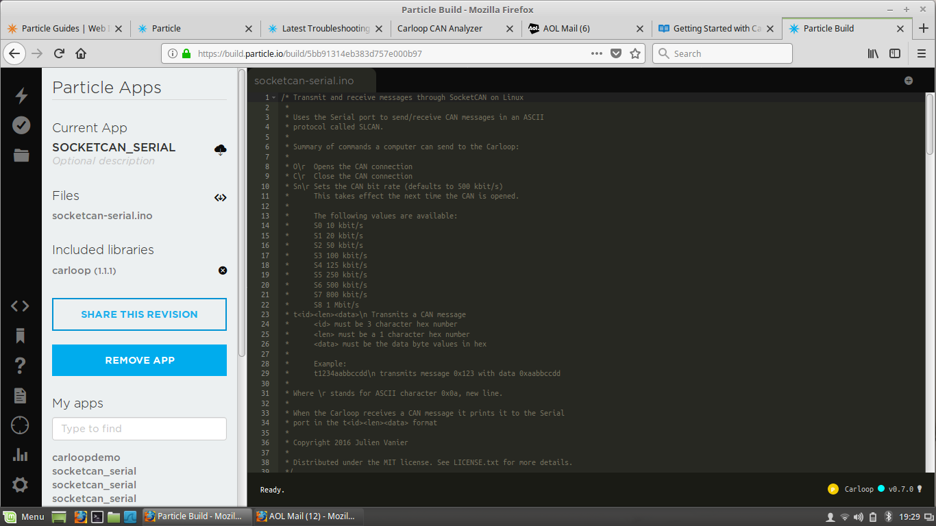

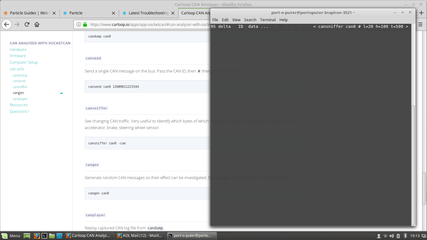

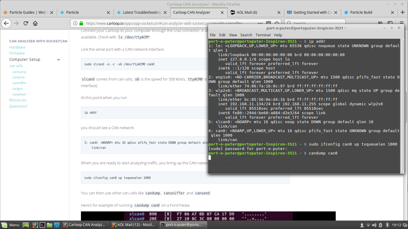

I took another shot at this. To the left are the directions I followed. As seen in the picture when running candump or cansniffer there is no data. Tried this on two different cars with them running. Maybe the Photon is not setup correctly. The last picture shows it’s current flashed app and it is in the “connected” mode when plugging into the OBD2.
