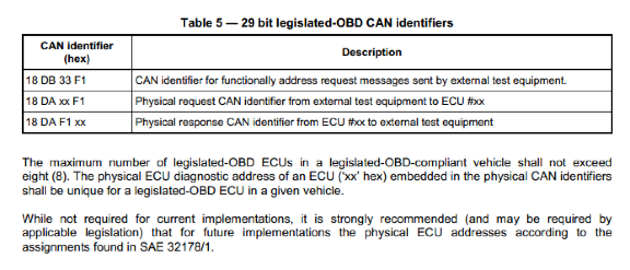

@cyclin_al1,
Thank you for the clarification and additional ideas! I figured out the problem and I have a very interesting explanation.
I have one of those generic scan tools that you can plug into the OBD port and check/reset trouble codes, see live data, etc. The scan tool works perfectly fine when I plug it in to my car. It reads live data like Vehicle Speed which the Carloop was unable to do. So I wanted to figure out why the scan tool worked and the Carloop didn’t.
I bought a simple OBD Y-splitter and connected the scan tool to one end and the Carloop to the other, so I could use the Carloop to monitor messages being sent to and from the scan tool. I discovered a few interesting things from this:
  • I need to use message ID 18db33f1 to send the request; 7DF does not work
  • The response has a message ID of 18daf111 or 18daf11d (probably depends on the responding ECU)
  • The last 5 bytes in the message data must be populated with a specific set of values; if these are set to 00 or 55, you will not get a reply; I won’t paste the values in here in case this is some kind of proprietary key not meant to be released to the public
After I made those adjustments, the Carloop worked perfectly to retrieve Vehicle Speed and RPM (didn’t try anything else). Hopefully this post has a few tips that help others. Thanks to everyone for your help!
Mike

Yes, that is correct. @cyclin_al1, in response to your question, based on the ISO 15765-4 Standard for CAN messages, that request ID is required for CAN buses with extended (29-bit) format. See table from ISO standard:
For 11 bit identifiers, the correct CAN IDs are:
