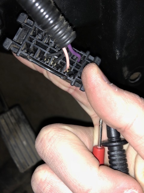

Just went out and took a look at the port - only 4 wires connected, signal ground, chassis ground, battery power and then what looks like an ISO signal. Measured voltage from battery to both grounds, it was sitting consistently at about 12V. I also measured voltage between pin 7 and both ground pins and saw ~6V. That said, I’m not understanding how my Photon could’ve seen any voltage beyond what the carloop was able to regulate to unless the problem is with the 6V at pin 7. This is the only place I have ever connected my carloop so unless the carloop voltage regulator was faulty out of the box or I’m getting some wild voltage swings the only thing I can think of is that the 6V at pin 7 is abnormal. Any ideas? Is this the expected result of connecting a virgin carloop to an ODB port configured for ISO - I just looked at the V2.3 schematic and it looks like PIN 7 isn’t routed anywhere - doesn’t seem like the 6V connection would’ve done anything? @cyclin_al1 - looks like you have had some experience with getting a carloop going for ISO - any suggestions?
I am not familiar with LandRover, but that looks strange to me. I would go hunting for some LandRover-specific information to see if there is something unusual with that plug. If LandRover did things totally differently, then who knows what is on each wire…
Assuming the purple wire is in fact pin 1, the layout makes sense for Voltage on pin 1 and the grounds on pins 4 & 5.
What does not make sense is to have something on pin 7 (should be K-Line) without having its partner on pin 15 (the L-Line).
Carloop does not use pins 7 & 15 (not connected), so any signals there on the OBD port will not have any effect on the Carloop. That narrows it down to pins 1, 4 or 5 causing something unexpected. However, pins 4 and 5 are connected together in Carloop, so that limits the effect even further.
One final conclusion: since you do not have a CANbus (which would be on pins 6 & 14), Carloop is not going to work for this vehicle. There is a project that is moving very very slowly to do CarloopRetro, which would do K-Line (pins 7 & 15), but this is different hardware (and firmware) from the regular Carloop.
