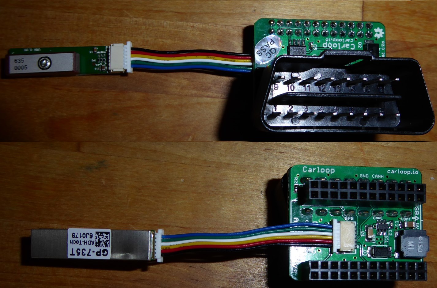

@jvanier, I just received my devices - is this pin reordering still required for Carloop R2.3 2016/05 and GPS GP-735T VRN 0.20?
Could you maybe also post an image of the correctly done done wiring?
And I hope the wrong wiring didn’t do any harm to the GPS module.
This is how mine looks currently (before reordering):
The Carloop 2.3 has the correct wiring for the GPS. I did not see negative impact to the GPS module of the wrong wiring so you should be ok.
The picture you took shows the correct wiring.
