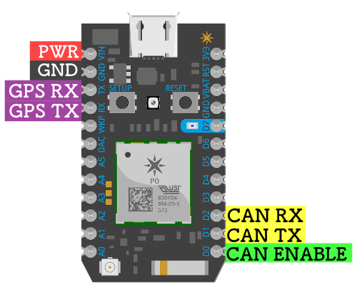

I need one bit of clarification though: Obviously the pins of the Electron that are hanging off the end are available for my own use. However, am I correct in assuming that the unmentioned PINs that are plugged into the Carloop are also available for my own use?
Are any of the unused pins mentioned below connected to anything, can I connect a jumper to the empty female connection that is adjacent (I see that your diagram has *2 beside each, does that mean both female connectors are connected)?

VIN
GND
TX (GPS TX)
RX (GPS RX)
WKP
DAC
A5 (GPS Shield)
A4 (GPS Shield)
A3 (GPS Shield)
A2 (GPS Shield)
A1 (VBAT)
A0 (GPS EN)
B5 (Unused / Off end of Carloop / Available)
B4 (Unused / Off end of Carloop / Available)
B3 (Unused / Off end of Carloop / Available)
B2 (Unused / Off end of Carloop / Available)
B1 (Unused / Off end of Carloop / Available)
B0 (Unused / Off end of Carloop / Available)
3V3
RST
VBAT
GND
D7 (Unused / Available)
D6 (Unused / Available)
D5 (Unused / Available)
D4 (GPS Shield)
D3 (GPS Shield)
D2 (CAN RX)
D1 (CAN TX)
D0 (CAN)
C5 (Unused / Off end of Carloop / Available)
C4 (Unused / Off end of Carloop / Available)
C3 (Unused / Off end of Carloop / Available)
C2 (Unused / Off end of Carloop / Available)
C1 (Unused / Off end of Carloop / Available)
C0 (Unused / Off end of Carloop / Available)
