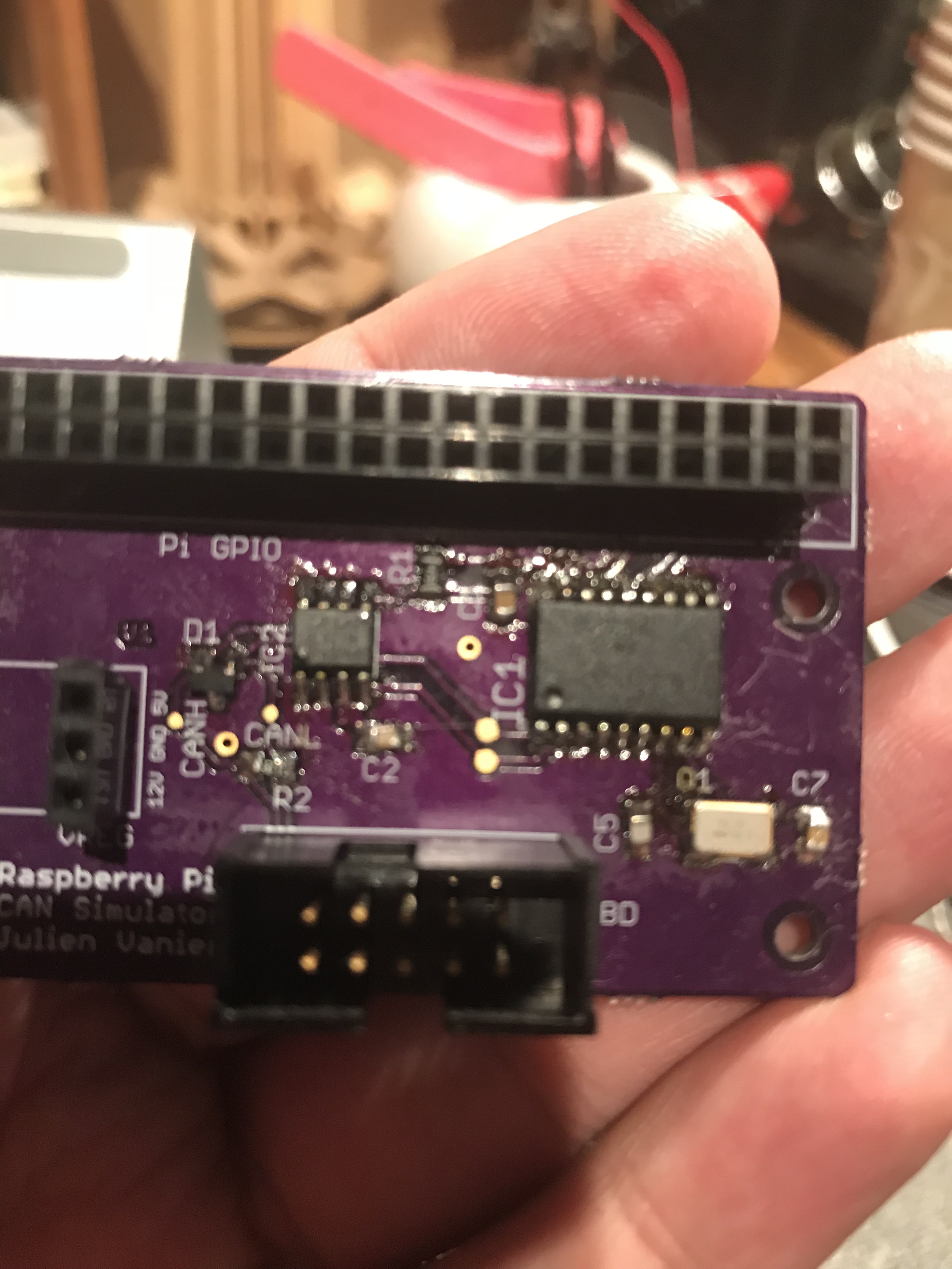

I tried my 2nd board, and I get the same error. I am decent at soldering some things, but these tiny components where beyond my skill level. There was a local electronics shop that I had do these two. I bought enough parts to make 3 of these, so I have the ability to make one more.
I’m taking both these boards to work tomorrow. There is a guy there who repairs all the hardware that we test on. He has a bad ass soldering station, nice large magnify glass. We’ll go through and try to test as much as we can.

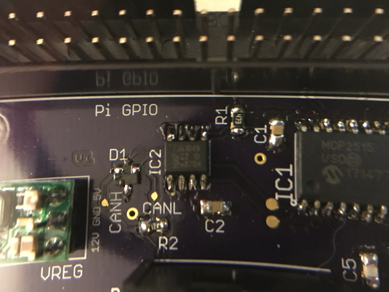

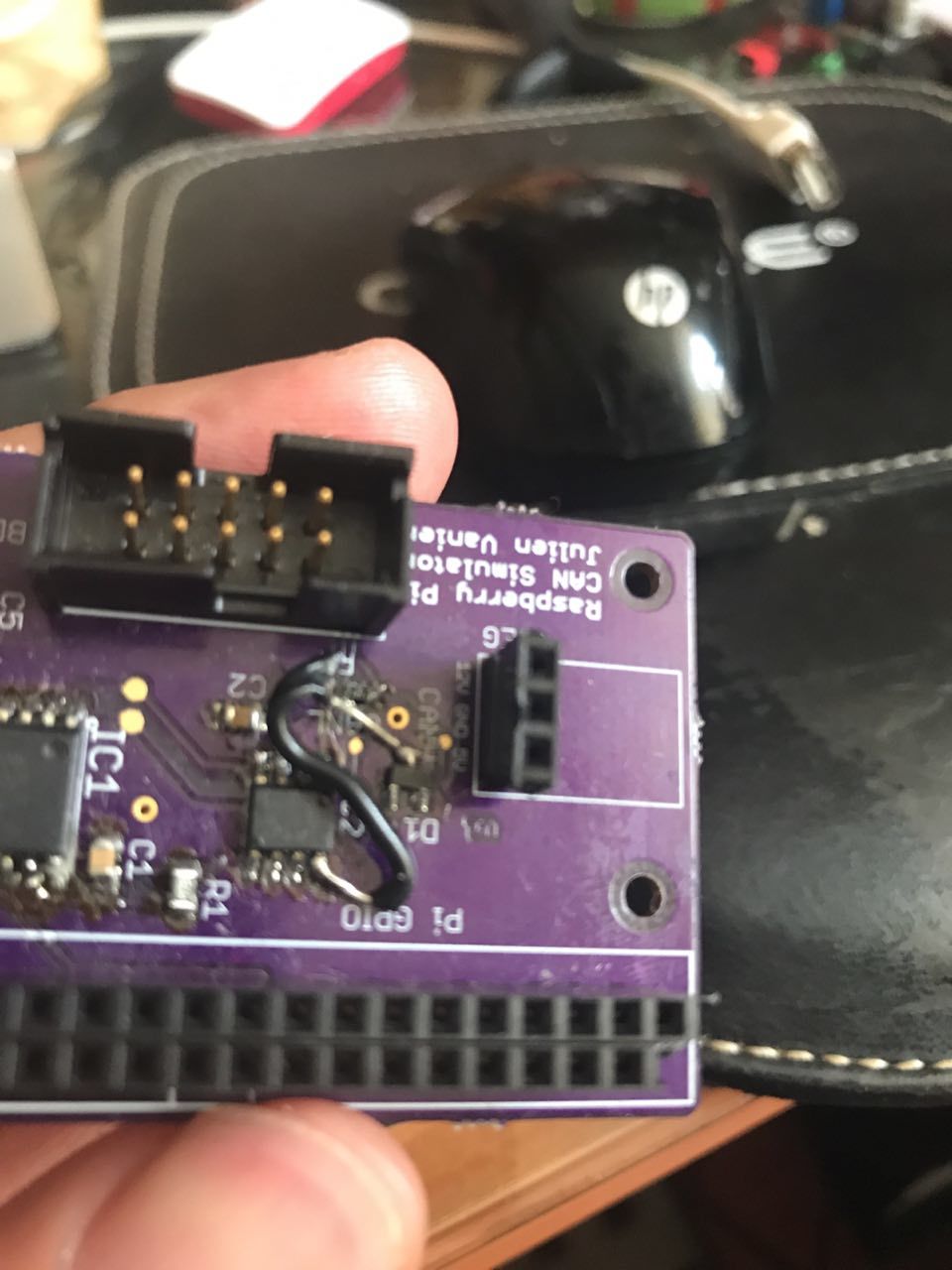

@cyclin_al1 - Here are some pics of what was done. I printed out the schematics from the github page and gave to the guy who did the soldering. He was very confident he could do it.
And another since I am tied to one picture per post
And the last one…

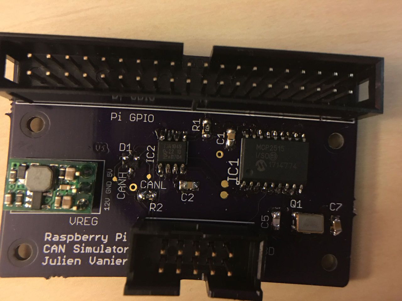

This is my first versión of the pcb. Looks like trey’s pcb (the Components looks well oriented).
So I took both my boards to work. The guy there tested them, and one had a bad 120ohm resistor, he replaced that. Then on the MCP2515 board connections, I don’t know how many cold solder joints he said there were on each board. So he re-did every connection on both boards. These boards are now bad ass looking, like a robot did it on the assembly line. Everything is also pin indexed as it should be.
All said and done, I still get the exact same message, on both boards.

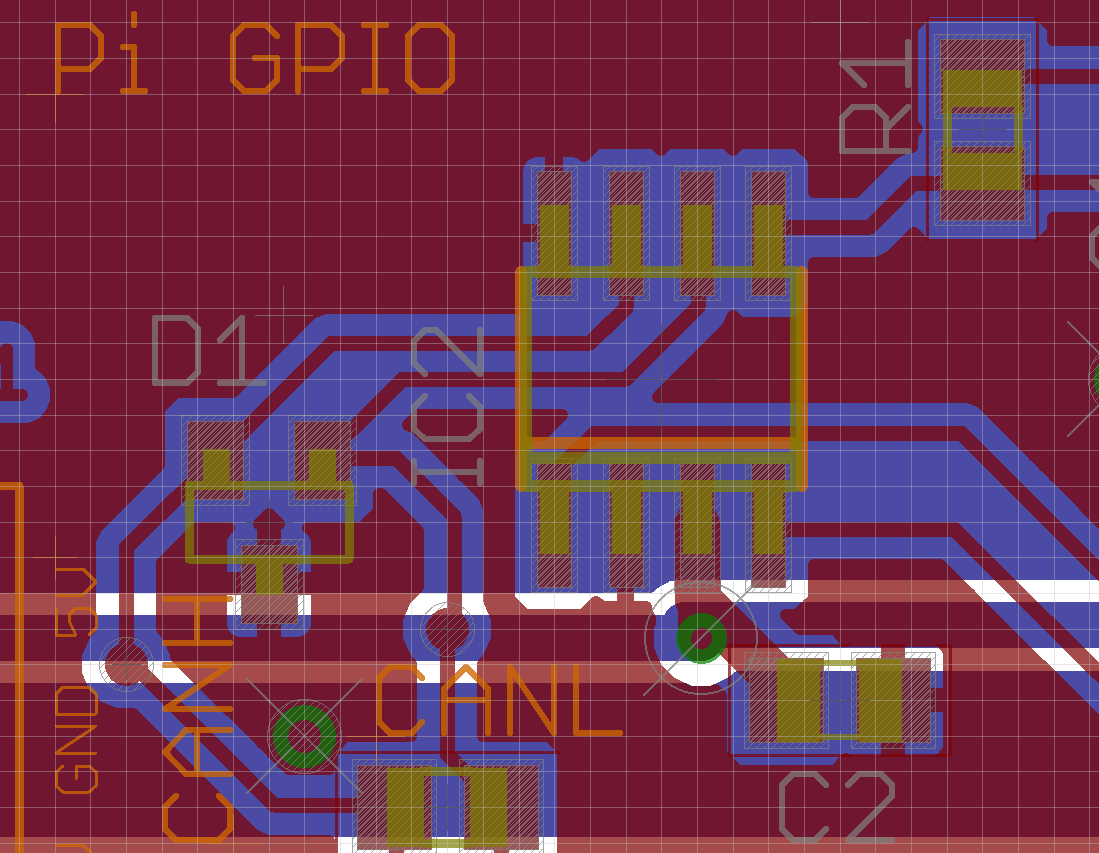

The hardware I’m using had a mistake where the CAN transceiver IC2 pin 8 (top left) was not grounded. I fixed it in the schematic, but it would be good to check that the top left pin of IC2 is at ground with a multimeter.

I had one of the boards with me here at work. I went and tested IC2 Pin8, and it is for sure NOT grounded.
I guess there is no path to ground in the PCB design? I got your version 1 board. Is this fixed in your version 2 board? I grabbed version 1, as that was listed in your Assembly Instructions.
I’m hopeful now that once I ground IC2 Pin8, everything will work.

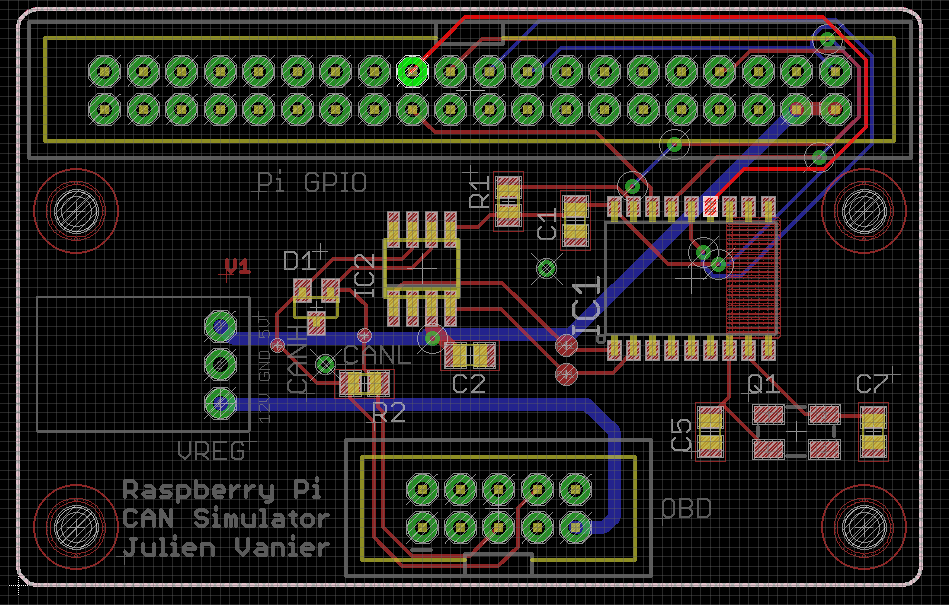

Can you do some testing on your board to ensure that the pins on the chips are not shorted to other pins, that power and ground make it to where they should? Essentially go over your board trace by trace to ensure there are no opens or shorts. Also, look for cold solder joints that are not connected when they should be. Also, look for excess solder that could be shorting pins together.
This is meticulous work and will take a bit of time. Compare everything you check with the schematic. Unofortunately, it is necessary to be this detailed to eliminate board assembly as a possible cause for this.
You should be able to do these tests with a multimeter using a continuity setting, with no power on the simulator circuit board.

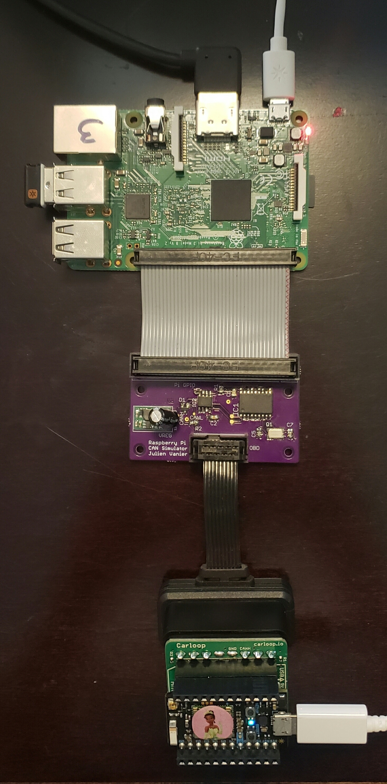

This is what my fully connected setup looks like (click on image to see the full thing). Pi 3 connected to CAN simulator board connected to Carloop.
Disregard the extra capacitor on the 12V regulator board. I was having the issue that connecting a Carloop was drawing too much current and resetting the Pi. I tried adding an extra cap to no avail. Now I just power the Carloop through USB first before plugging it into the simulator board.)
I flashed this app (source on GitHub) on the Photon connected to the Carloop to transmit a message at a regular interval.
When running the simulator-program on the Pi 3 it I see the printout of the CAN messages transmitted by Carloop.
I can reproduce “Error occured: CAN chip not responding” by unplugging the CAN simulator board and restarting the simulator-program.

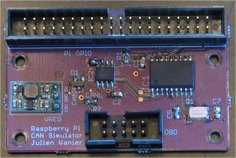

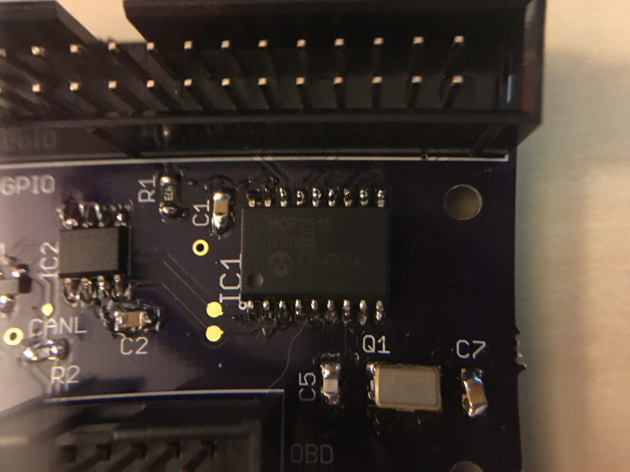

Here’s a closeup of my assembled board.
