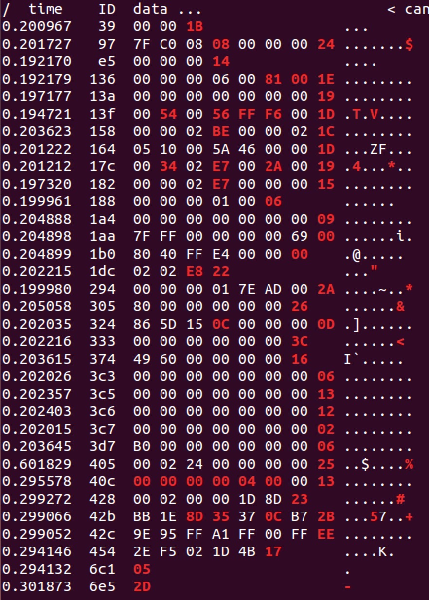

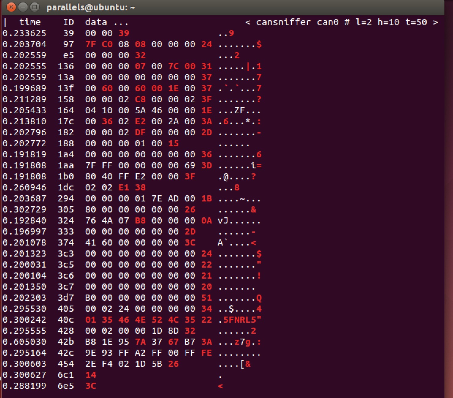

nice work! now try the following:
cansniffer -cae can0
and do another screenshot
Also is there any good documentation for canutils? For example, what does the section on the right side represent (where you see the … that change from time to time)
The text you see on the right is simply ascii representations of the bytes. Sadly, mostly useless in for obd info (or at least in my experience)
What you’re looking at are the raw broadcasted values on the bus. Some are broadcasted, other messages are not. example - VIN.

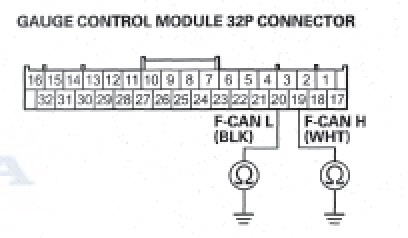

I built a simple test rig by learning the pinout of my Honda Odyssey cluster. It is a 32 pin connector. For purposes of this test, I used 2 12V power lines (pins 1 & 17), 3 grounds (pins 4,31, 32), HSCAN+ and HSCAN-. There are pins for low speed CAN (125kbps) but I am not playing with those yet. The setup is powered by 8 AA batteries. I added a 125 ohm resistor between the data lines on my breadboard.

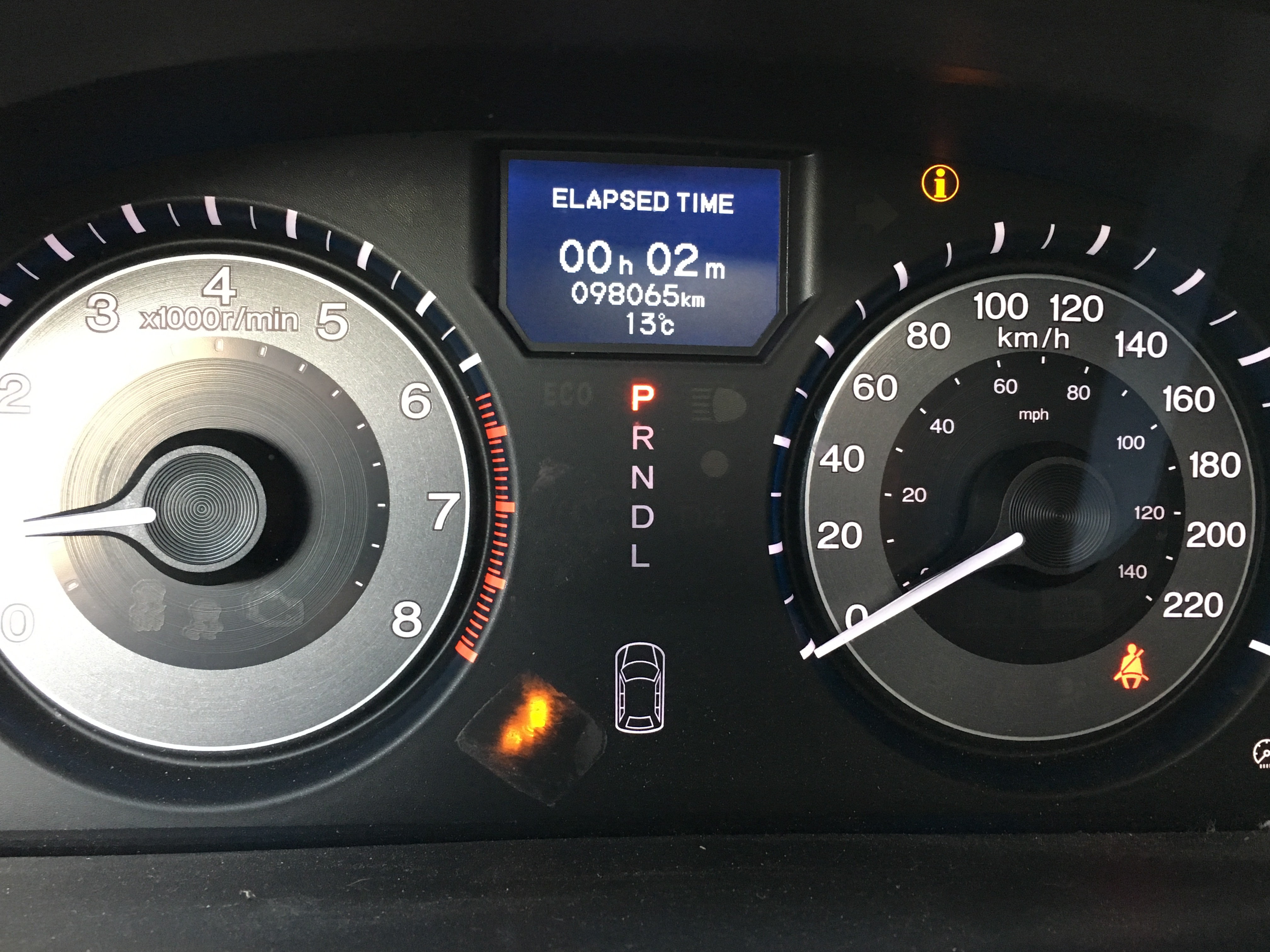

Next comes the fun part…I ran canplayer -I [filename] to play my data into the test cluster. Voila, the cluster showed the RPM from the start of the file!
Unfortunately the fun only lasted for a few seconds, as I keep getting a “no buffer space available” error. The only way to clear it is to turn the cluster on and off. Any suggestions on how to fix this? The output below might be interesting. Also here is a movie showing the tach move!

In the video I just noticed that before the file errors out the TPMS light turned off! So in theory I can now isolate the “good TPMS” CAN messages, disconnect my TPMS module, and publish “good TPMS” CAN messages using a Carloop!
